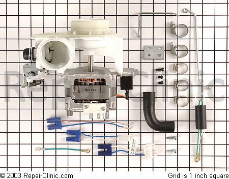

I have a GE Potscrubber 650 dishwasher. I'm not sure how old it is. Two nights ago, I ran the dishwasher and in the morning I noticed a puddle on the floor. I removed the lower front panel and looked underneath with a flashlight. I saw water dripping from the motor. As the day went on, the drip got less and less. This morning I ran it again to see what would happen. It continued to drip, but became more after I cancelled the cycle. This morning I turned off the power and shut off the water, then removed the dishwasher from its space. I tipped it over on its front to get a better look at the bottom. When I did this, I heard a good amount of water slaushing around. Even though there was no water visible inside the machine. After inspecting the bottom, it seems that the water is coming from a white piece of plastic that connects the motor and drain hose together. Here is a link to an image I found. http://www.rcappliancepartsimag...es/00000598/00181477.jpg  I'm not really sure what to do. I'd like to fix this myself if possible. The motor itself seems to still be running fine, but the leak is pretty bad. Do I need to replace this part? Could it just be an o-ring? What should I do?

Sounds like its leaking from pump housing..

Do you think I would have to replace the whole pump since the housing is attached?

Can you see upon inspection any cracks or place marked from water leaking from it? Hard to say without seeing it. personally I would

I didn't find any cracks. On the top of the houseing (according to picture) where the motor shaft extends to, I found a piece of plastic wrapped around the shaft end. I also found a piece of glass and a piece of gunk stuck in that grate. Perhaps the plastic partially jammed up the motor, causing it to overheat and damage the housing... just a thought. To replace a $150 part on an old washer, maybe it's better to replace it at this point. What are your thoughts/suggestions moving forward?

Personally if its over 10 years i would just replace, energy saving model.. and not go to expense of redoing pump assembly and then having to worry about something else letting go. Like I said without being able to see area hard to say

Not a problem.. Can alwayss take the pump out and make sure there isnt a crack or a seal leaking and then descide
