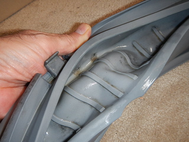

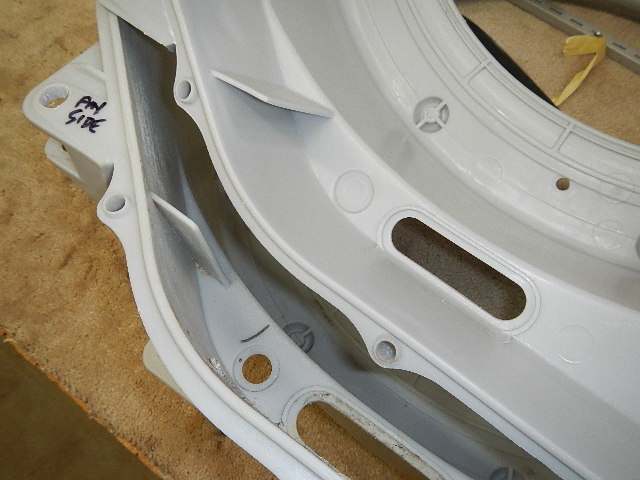

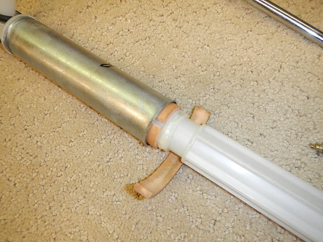

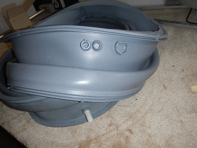

Ok, need some advice. First, you said you could email me some diagrams which I would appreciate. Can you get my email address from my order# 3307917? Don't want to post it here. Here are questions related to attached photos... Dampener: In taking off the front tub housing, I pulled the dampeners apart. They look fine, and slide back together easily. [LIST=1] Are the rubber rings supposed to be split? If yes, do they need to be put on 180 degrees offset to get better seal? Do they need to be lubricated, if so with what? Should they be pretty stiff when manually testing them?[/LIST]Which Hole: The newer design tub seal has three areas marked for cutout, but none are. [LIST=1] I'm guessing I use the one with the "X"? Any special method to cut the hole without otherwise damaging the seal?[/LIST]Thermister hole missing: The new front tub cover does not have a hole for the thermistor. [LIST=1] Any specs on it or measure from old and drill it out? I want to avoid leaks![/LIST]Heater Gasket: It looks like it either had some type of sealer on it or it's just gunk. Any special instructions on re-installing, again to assure no leaks?
Lastly, the spring removal tool I bought looks like it's only designed to be used on the inner spring, not the outer. What's the preferred way to get the outer spring re-installed?
Thanks for your help guys, this is quite a project, hopefully will be worth it to get rid of the yuck of the old design.mce3 attached the following image(s):
